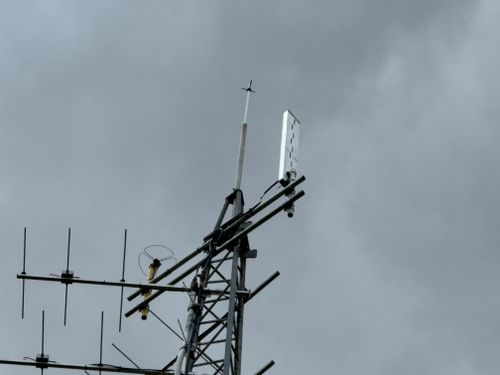

Site Overview
GB3OO sits at a rural hilltop location near Folkestone, chosen for its excellent coverage across the surrounding area. The installation is built around a self-supporting lattice mast: at the summit, the 23cm slotted-waveguide transmit antenna and the 70cm "Big Wheel" receive antenna are mounted together. A brick-built equipment building at the base of the tower houses the full repeater rack.

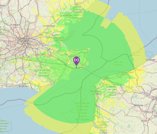

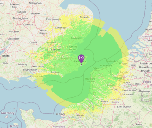

Coverage
GB3OO's 23cm output covers a large area of Kent, Essex, London, and across the Channel into northern France and Belgium — conditions permitting, and especially well during tropospheric ducting.
The 70cm receive input has a correspondingly wide catchment for stations wanting to transmit into the repeater, fed by an omnidirectional dual-stack WIMO "Big Wheel" antenna (5 dBi gain).
During good tropo conditions, continental stations from France, Belgium, and beyond are actively welcomed — the repeater's French-language announcement specifically invites this.
Transmit Chain
The transmit chain starts at the power amplifier, delivering 10W RF output at 23cm.
- Feeder run: 4m LDF5-50 7/8" Heliax tail → 30m LDF6-50 1-5/8" Heliax main run (the larger diameter minimises loss over the long vertical run) → 2m LDF5-50 tail to the antenna feed point
- Connectors: 7/16 DIN throughout (chosen over N-type for low loss and superior intermodulation performance at these power levels)
- Antenna: Slotted waveguide, designed and built by Bert Moderman (PE1RKI) — seven radiating slots per face on two faces, giving an omnidirectional azimuth pattern within ±1.3 dB and 12 dBi gain
- Result: 150W EIRP, meeting the licensed limit once feeder and coupler losses are accounted for
- Return loss at commissioning: 30.5 dB — an excellent match, important at 23cm since poor return loss on a long feeder causes standing-wave echoes that visibly degrade DVB-S2 signal quality (closing the constellation "eye," raising EVM, lowering MER)

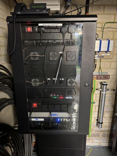

Equipment Rack
The repeater is housed in a wall-mounted 19" × 450mm(d) × 18U rack with removable side panels and a lockable glass front door. Two continuously-running 240V axial fans provide cooling, with heavy electrical loads mounted toward the top to keep a cool zone at the bottom of the cabinet.
Rack layout (bottom to top):
| RU | Contents |
| 1 | Cable management brush strip |
| 2 | Raspberry Pi shelf — media player, stream receiver, 70cm receiver |
| 3 | Network equipment — UniFi UCG firewall, 7-port PoE switch |
| 4 | Windows 11 PC — Bitfocus Companion software, VLC for audio announcements |
| 5 | Mains distribution 2 (low-power devices) |
| 6 | Pull-out drawer — Blackmagic ATEM Mini Pro video switcher, 2m receiver, 1TB SSD local storage |
| 7–8 | Receiver shelf — BATC Minitiouner |
| 9–10 | HF modulator, H.264 encoder, Modbus TCP/RTU telemetry |
| 11–12 | Ventilation panel |
| 13–15 | Power amplifier |
| 16 | Cable management brush strip |
| 17 | Air-tight blanking panel |
| 18 | Mains distribution 1 (PA, exciter, case fans) |
