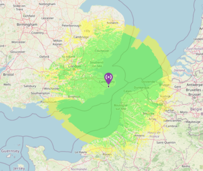

Coverage
GB3OO's 23cm output covers a large area of Kent, Essex, London, and across the Channel into northern France and Belgium — conditions permitting, and especially well during tropospheric ducting.
Predicted 23cm coverage (green = strong signal, yellow = marginal).

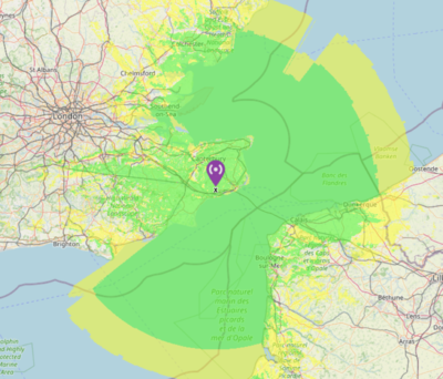

The 70cm receive input has a correspondingly wide catchment for stations wanting to transmit into the repeater, fed by an omnidirectional dual-stack WIMO "Big Wheel" antenna (5 dBi gain).
Predicted 70cm receive coverage.

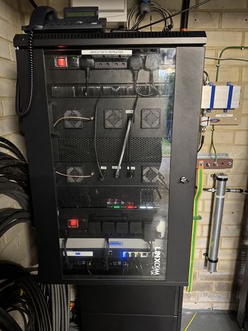

Equipment Rack
The repeater is housed in a wall-mounted 19" × 450mm(d) × 18U rack with removable side panels and a lockable glass front door. Two continuously-running 240V axial fans provide cooling, with heavy electrical loads mounted toward the top to keep a cool zone at the bottom of the cabinet.
GB3OO equipment rack.
Rack layout (bottom to top):
RU Contents
1 Cable management brush strip
2 Raspberry Pi shelf — media player, stream receiver, 70cm receiver
3 Network equipment — UniFi UCG firewall, 7-port PoE switch
4 Windows 11 PC — Bitfocus Companion software, VLC for audio announcements
5 Mains distribution 2 (low-power devices)
6 Pull-out drawer — Blackmagic ATEM Mini Pro video switcher, 2m receiver, 1TB SSD local storage
7–8 Receiver shelf — BATC Minitiouner
9–10 HF modulator, H.264 encoder, Modbus TCP/RTU telemetry
11–12 Ventilation panel
13–15 Power amplifier
16 Cable management brush strip
17 Air-tight blanking panel
18 Mains distribution 1 (PA, exciter, case fans)
Exciter Shelf
The modulator is an SR-Systems "Minimod" HF modulator paired with an SR-Systems H.264 encoder, managed via a VT-100 emulation RS-232 interface accessed over Telnet through an in-built terminal server on a fixed IP.
The exciter shelf also carries the transmitter telemetry, via Modbus TCP/RTU:
  • Temperature sensors (PTC): exciter air outlet, PA air outlet, PA heatsink
  • Digital relay outputs: exciter load/PA co-ax relay, ATEM power on/off (cold reset only)
  • Analogue input: PA forward power
  • Digital output: PA power switching (local relays in the PA shelf)
