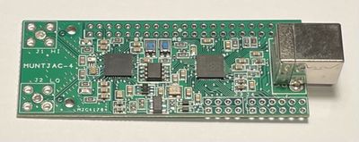

The Muntjac SDR was designed by Brian G4EWJ based on the same dual-band AT86RF215 RF chip as the commercially available CaribouLite SDR.
It is a transmit-only SDR for DVB-S2 DATV on 13cm (QO-100) and 70cm, which uses an RP2040 micro-controller, as used on the Raspberry Pi Pico, to provide a USB interface to the Portsdown 4.
When operating from the command line, the same transmission may be made on both bands simultaneously.
The 75 x 30mm board comes without SMA connectors, so that it can optionally be wired into a system, for maximum flexibility. Long thread SMA types are recommended.
The optional user-fitted ADE-30+ mixer is shown, which can be used for experiments on other bands. DATV is generated on the high band and mixed with the harmonic of a carrier on the low band. In theory, output on all bands from 1.8MHz to 3.4GHz is possible, but this is subject to further investigation.
The flash chip has a capacity of 16M bytes, the maximum value for the RP2040 microcontroller. This gives plenty of room for software expansion and perhaps storing of transport streams to use as a beacon.
Muntjac-4 was meant to be intermediate development version, but it is working well enough to make it available as part of an extended beta trial. Some configuration in Linux may be necessary, so if you don't consider yourself to be an 'early-adopter' it may be worth waiting until it has matured.

The Muntjac is supplied as a kit with the final assembly step of soldering the output connectors to the PCB required for completion. The SMA connectors are not supplied. If the SDR is to be mounted in a box (it does fit a small die-cast box) right-angle SMAs with long shafts should be used to allow sufficient clearance between the SMA plug and the box. An suitable example connector is this: https://www.mouser.co.uk/ProductDetail/TE-Connectivity-Linx-Technologies/CONSMA002-L-G?qs=vLWxofP3U2xfxfFnu8BdmA%3D%3D

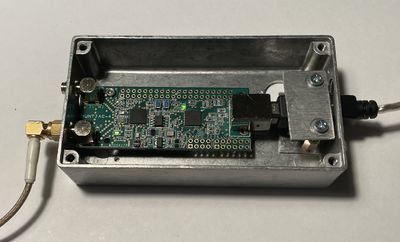

An example of the Muntjac mounted in a box (with short SMA Conectors) is shown here.
Another Boxing Idea
As Muntjac-4 was meant to be an intermediate development version, not much thought was given to fitting it into a box.
The Hammond 1550P can be used by cutting slots into the top edges of the box and dropping in the Muntjac-4 board vertically.
The 1550P is about £6 in bare metal and about double that as the 1550PBK with a black finish.

Muntjac Input/Output Connectors
The 40 pin J101 position will enable the Muntjac to connect directly to a Raspberry Pi. This will provide power and also an SPI connection instead of USB, allowing higher data rates for future development. It is recommended that no connector is fitted here until the required orientation and gender is known.
The 8 pin J3 position can be used for general I/O or to allow future developments to connect a WIZnet Ethernet module for applications that do not require a Raspberry Pi.
The 12 pin J4 position is for general I/O.
3.3v power is available on J3 and J4. The available current is yet to be determined, but likely to be around 100mA.
All Muntjac I/O pins on J3 and J4 are connected directly to the RP2040 microcontroller, so caution should be exercised regarding static and voltage levels. 3.3v is the nominal voltage level.
There are no pins on J3 or J4 that connect to J101.
