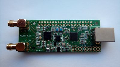

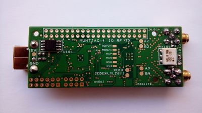

The Muntjac SDR was designed by Brian G4EWJ based on the same dual band AT86RF215 RF chip as the commercially-available CaribouLite SDR.
It is a transmit-only SDR for DVB-S2 DATV, that uses an RP2040 micro-controller to provide a USB interface to the Portsdown 4.
The 75 x 30mm board will come without SMA connectors, so that it can optionally be wired into a system for maximum flexibility.
The optional user-fitted mixer is shown, which can be used for experiments on other bands. DATV is generated on the high band and mixed with the harmonic of a carrier on the low band.
Muntjac-4 was meant to be intermediate development version, but it is working well enough to make it available as part of an extended beta trial. Some configuration in Linux may be necessary, so if you don't consider yourself to be an 'early-adopter' it may be worth waiting until it has matured.
