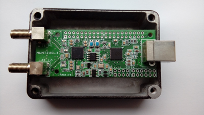

The Muntjac is supplied as a kit with the final assembly step of soldering the output connectors to the PCB required for completion. If the SDR is to be mounted in a box (it does fit a small die-cast box) right-angle SMAs with long shafts should be used to allow sufficient clearance between the SMA plug and the box.
An example of the Muntjac mounted in a box (with short SMA Conectors) is shown here.
