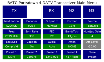

First Transmission
If you're not familiar with the Portsdown, set the lines starting 'Modulation', 'Freq' and 'Easycap' as shown and enter your callsign via 'Menu 3' and 'Set Call, Loc & PIDs'.
Press 'TX' and after a second or two, the Muntjac main LED near the buttons will start double blinking off and the LED near the high band SMA will light steady.
