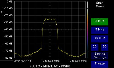

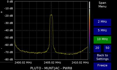

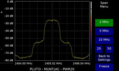

The plots below show the effect of the power setting on the level of the shoulders at SR333. Shoulders are generally lower on 437MHz for the same power setting.
The rising levels at the edges of the plots are an artefact of the Pluto band viewer, as shown by the PWR8 plot in a 10MHz bandwidth.
