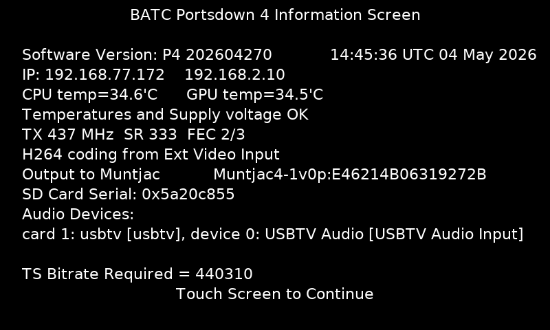

Make sure that "Output to" on the Portsdown main menu is set to Muntjac. If this is the first time that this Muntjac has been connected to this Portsdown, change "Output to" to something other than "Muntjac" and then back to "Muntjac". The Portsdown will recognise a new Muntjac and the Portsdown will reboot itself as part of the Muntjac registration process.
When the main LED on the Muntjac is lit steady, on the Portsdown, select "M2" and "Info" and the Muntjac firmware version and serial number will be displayed as shown below.
