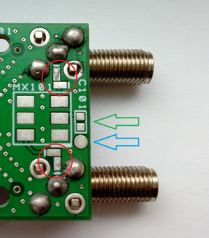

Fitting and Using the Onboard Mixer
Caption text
Fit the mixer here, with its pin 1 dot marker close to the thick bar at the south-east of the pcb legend. An ADE-30+ has been used for testing. Other mixers may look the same, but may have different pinouts.
