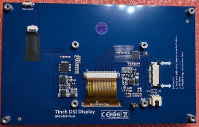

The Portsdown 5 has been designed to be compatible with any DSI-connected 800x480 touchscreen. It is not compatible with HDMI touchscreens or DPI-connected displays. It is not possible to guarantee compatibility with any particular touchscreen (apart from the official Raspberry Pi screen), but the Waveshare 7 inch display pictured below seems to work well as long as it is powered through the power connector; the pogo pns have proved unreliable.
