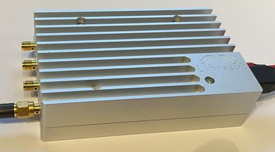

The Portsdown 4 supports transmission using the LibreSDR with the firmware supplied by DL1JM and PA2JSA. It has been tested with firmware versions 0226 and 0326 (builds 1.20 and 1.21).
Initial Set-up
The link to the firmware is available from PA2JSA. Contact via the e-mail address on his qrz.com page
Download the firmware and unzip to get a .img file. Using software such as Win32 Disk Imager, write this image file to an SD Card. Firmware versions 0226 and 0326 (builds 1.20 and 1.21) have been tested so far.
Insert the SD Card into the LibreSDR, connect it to the LAN, and apply power to the LibreSDR through the "OTG" slot. The power can be derived from one of the the Raspberry Pi USB sockets, but note that no data is passed over this connection.
After it has booted up, you should be able to "ping libre" from the command line of any Windows or Linux PC on the network. This will display the IP address of the LibreSDR, which you can then enter into a browser to read the documentation. However, this step is not necessary for use with Portsdown.
