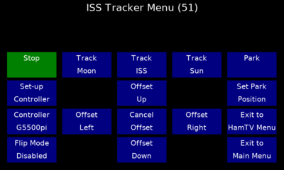

To access the rotator menu, go to M3, ISS HamTV RX Merger, ISS Tracker Set-up.
Before use, the Controller needs to be configured. Set either "Controller G5500pi" (the default) or "Controller HamLib".
If using the G5500pi controller, select "Set-up Controller" and enter the IP address and port of your controller in the format 192.168.2.140:8008. You may find it useful to allocate a fixed IP address in your network router for the controller.
If using the HamLib controller, select "Set-up Controller" and enter the HamLib device address. This is typically in the format /dev/ttyUSB2. Next enter the model number (the number in the first column of the table below), and the baud rate (typically 9600).
You should also enter the desired park position for your dish; the controller will move the dish to this position at the end of every pass. Select "Set Park Position" and enter the azimuth and elevation.
The configuration settings are stored for future use.
Now select "Track ISS". You should see the demanded position for the ISS displayed above the buttons, and the dish will move to track the position if it is more than 5 degrees above the horizon. Selecting "Track Moon", or "Track Sun" will also display the demanded position, and the dish will track if above 5 degrees.

The controller always assumes that the rotator has an end-stop at North. To cater for ISS passes that are North of the dish location, and to better cater for overhead passes, 4 Flip Modes are available. The Flip mode button cycles between these 4 modes:
  • Flip Mode Disabled. In this mode the maximum demanded rotator elevation will be 90 degrees. On ISS passes North of the dish location, some tracking time will be lost just after apogee as the rotator travels nearly 360 degrees to get to the other side of the North end-stop. Note that this mode is the only mode comaptible with rotators that cannot achieve more than 90 degrees elevation.
  • Flip Mode Auto. This mode is a placeholder for a future capability to enable unnattended auto-selection of Flip Modes. Currently it has the same function as "Flip Mode Forced" below.
  • Flip Mode Forced. In this mode, the azimuth is set to (demanded azimuth =/- 180 degrees) and the elevation is set to (180 - the demanded elevation). The effect of this is that the dish tracks the ISS "upside down" (beware waterproofing!) and the rotator end-stop is "moved" to South enabling continuous tracking of ISS passes North of the dish location.
  • Flip Mode Half-flip. This mode is designed to cope with overhead, or near-overhead, passes where the ISS is within the dish beamwidth at apogee. Normally, such passes would need the azimuth rotator to transit 180 degrees after the ISS passed apogee, resulting in the loss of several seconds of tracking after the apogee as the demanded elevation decreased but the rotator was transiting through South while the ISS was in the East. In this mode, the tracking is normal until the ISS reaches an elevation of 80 degrees. Then the azimuth is frozen while the elevation still tracks to apogee; at apogee, the elevation enters flip mode, meaning that it continues to track the ISS through the overhead. Once the ISS descends through 80 degrees again, the azimuth control is unfrozen, but in flip mode, allowing continued tracking to the horizon.

Offsets
The 5 offset buttons are provided to allow exact alignment of the dish on the sun before ISS tracking. To achieve this, set up a Noise Meter (such as the Portsdown Lime or Pluto Noise Meter) in place of your MiniTiouner (or SDR) in your HamTV receive set-up.
  • Point the dish at the sun, and then use the "Offset UP" button to move it 10 - 15 degrees higher than the sun in a piece of cold sky. Zero the reading on the Noise meter.
  • Then press "Cancel Offset" and you should hopefully see the noise rise on the Noise Meter as Sun Noise is received.
  • Apply an offset of 3 or 4 degrees in each direction in turn and observe whether there is any increase in noise with the offset (indicatiing that the dish alignment needs to be adjusted) or whether is decreases in all directions (indicating correct alignment). Note that an offset of 3 or 4 degrees will need to be applied in each case to make the dish move - many rotator controllers will not move for only 1 or 2 degrees of demanded movement.
  • If you need to make a physical adjustment to the dish repeat the 3 steps above to confirm alignment.
Any offset is applied to ISS Moon or Sun tracking in "Flip Disabled" mode. It may be applied incorrectly in Flip modes - the maths has not been tested!
