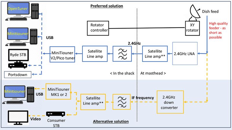

* The LNA / Downconverter should placed as close as possible to the dish feed and high quality microwave cable must be used. * The upper blue-boxes option is the preferred solution for new builders. * In the blue-boxes option the line amplifier and filters are at 2.4Ghz and GOOD (not cheap) quality satellite co-ax must be used to avoid the RF level being too low at the receiver. * The satellite line amplifiers are required to ensure there is enough signal at the receiver input - these may be placed at masthead or in the shack * The filters are essential, not nice to have! * The Minitiouner V2 / Pico tuner USB receiver can be connected to EITHER a PC running OpenTuner or Minitiouner software or a Pi4 based Ryde set top box receiver.
See the sections below for a full description of the elements in the diagram.

LNA and Pre-amp
A low noise pre-amp (LNA) should be connected directly to the antenna feed point via very high quality feeder to minimise losses. A good LNA should have noise figure (NF) less than 1db and a gain of at least 15 dB.
Commercial LNA Options
- Medium cost, good performance: Minicircuits ZX60-242GLN-S+ - 28dB Gain @ 0.9dB NF
- Low cost, acceptable performance: Nooelec LaNA - 12dB gain @ 1.5dB NF
Note that very high gain units such as the Kuhne LNAs (60dB gain) can be easily overloaded by WiFi and other RFI without a filter placed in front, which will reduce their performance.

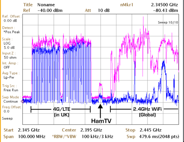

S-band is high demand spectrum for ground communications and so it's extremely likely that you'll have strong local signals, requiring good filtering in your system.
2.4GHz WiFi is the most common issue, as shown on the right in the spectrum capture below. The WiFi signal is intermittent so can be hard to detect on some systems, but a strong un-filtered 'data-burst' can cause receivers to lose lock for several seconds.
In the UK we have an additional problem of a 4G/LTE band in 2350-2390MHz, shown here on the left. This is a more constant signal but the very strong power can overload amplifiers/receivers in your system and so degrade your HamTV reception, particularly when pointing at low elevation angles.
It is desirable to put the filter AFTER the LNA so the noise figure of the system is not degraded by filter loss. However, you must ensure the LNA is not driven into compression (overloaded) by other local signals - if this is happening then the filter should be placed before the LNA at masthead as otherwise the HamTV signal may not decode.
If you are using a downconverter, the filter can be at the IF frequency as long as the downconverter is not overloaded by the WiFi.
Multi-pole interdigital filters work well for this, and should ideally be tuned to provide a low-pass roll-off above 2396MHz.

Receive co-ax cable
It is recommended to use professional grade satellite co-ax. If you are using a long cable run you must check the received signal level at the receiver - see below.
Receive Line amplifier
Satellite TV receivers need a high level of RF signal - they are designed for use with satellite LNBs which have ~55dB gain. Your masthead pre-amp must be followed by at least one satellite TV line amplifier with greater than 30 dB gain.
Your masthead LNA/LNB MUST have enough gain to overcome your co-ax cable loss. The satellite line amplifier can be placed at masthead if needed to help overcome the feeder loss or in the shack. To hear more about the importance of noise figure and gain distribution in a DATV receive system watch https://youtu.be/lfSi7vTQK44?si=wn_wLBjxco3_RnAf
You can check if you have enough gain in your receive system by checking the RF signal level on the Ryde, OpenTuner, MiniTiouner or Portsdown DATV receivers - the noise floor should sit between -30 to -70dBm when not receiving any signals.
If you are powering the LNA at masthead up the co-ax, you will need to place the DC inserter AFTER the filter.

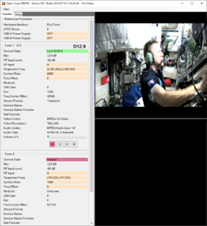

Instructions on how to set OpenTuner up for receiving HamTV (updated 30 July 2025) are here: OpenTuner for HamTV

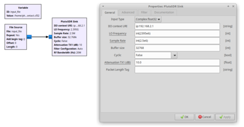

The recommended method is to use a Raspberry Pi 4 with the Portsdown 4 software and a Pluto SDR. Follow the simple instructions on this page to set this up Testing a HamTV Receiver using the Portsdown. A LimeSDR is a suitable alternative to the Pluto.

GNUradio + [PlutoSDR, Lime SDR, USRP, etc.]
Download an IQ file from the ARISS Media store, for example from the UK Contact in late 2025: https://live.ariss.org/media/HAMTV Recordings/IQ Files/2025-10-18 Radford Semele UK/
The files are (g)zipped complex samples, these will need decompressing (unzipping) before use. (.cf32.gz -> .cf32)
Then these can be played back in GNUradio as 'complex' data type, for example using a PlutoSDR with the PlutoSDR Sink Block:
Actually receiving HamTV
All that remains is to wait until it is confirmed that the HamTV transmitter has been turned on then set your tracking program to follow the ISS and wait for the magic signs on the spectrum display (BandViewer?) or lock indicator that you are receiving the signal!
Once you have successfully received the HamTV transmission, the Dsave button in MiniTioune can be used to record data such as RF level, MER and Vber to show how well and for how long you received the pass.
