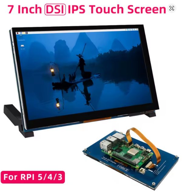

Alternative 7" Touchscreen
During 2025, 7 inch touchscreens that are reported to be compatible have become available on AliExpress for about £25. The description is generally: "7 Inch DSI Touch Screen for Raspberry Pi 5 4B 3B+ 3B IPS Display 800*480 LCD MIPI CSI Cable With Standard Monitor for RPI 5 Pi5". The key points here are that it must use a CSI or DSI cable, and must be 800*480. Be very careful buying from AliExpress - it is very easy to buy the wrong (incompatible) item!
Note that this touchscreen initially may not appear to respond to touch commands; follow the instructions below to rotate the touch overlay and you can correct this issue.
On initial build with this screen, the Portsdown touch map is rotated by 180 degrees. This can be corrected by navigating to Menu 3, System Config, Invert Touchscreen. If you can’t work out exactly where to press, here are the touch points:
  1. Preset 1 (Menu 3 should then be displayed)
  2. M2 (the System Configuration Menu should then be displayed)
  3. Just above Web Control (the reboot question should then be displayed)
  4. The "d" of inverted (the system should then reboot)
Alternatively, log into the SSH Console menu, select Display and Invert.
